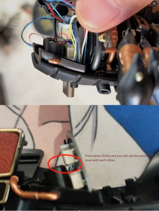

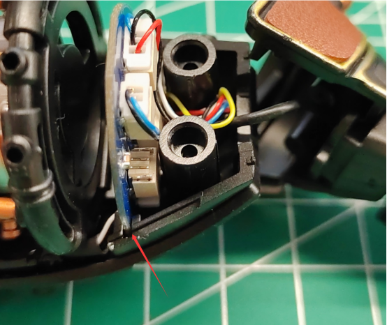

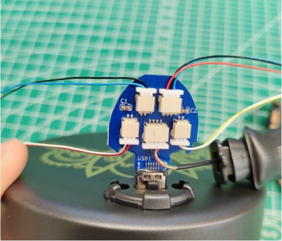

  1. The correct way to plug the wires: plug the wires into the base with the circuit board.

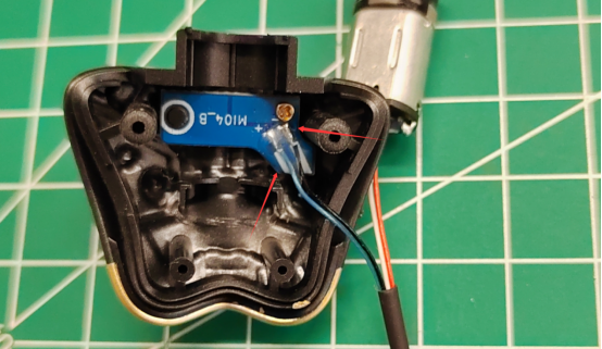

  1. The blue and black wires of P3 correspond to the positive and negative poles respectively. If this part fail to check the connection, please contact customer service to re-issue the part.

  1. The light is on / flashing, but the motor does not rotate: check if the circuit board is inserted into the bottom.
