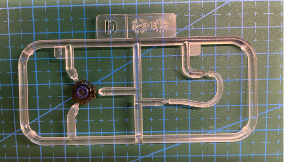

  1. The board D is transparent.

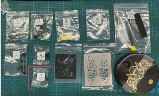

  1. Bag No.7 = Bag No.X1: the screws are the same.

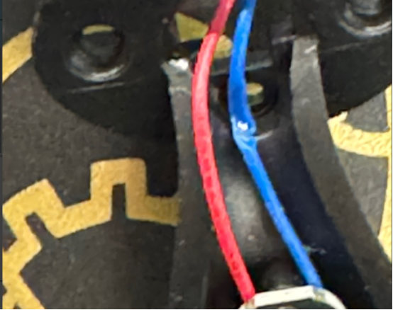

① Check the battery: there can be no old batteries or positive and negative poles.
② Check the switch: touch the switch at the bottom switch box.
③ Check the assembly direction of the base power switch; check if the power switch wire is crushed.

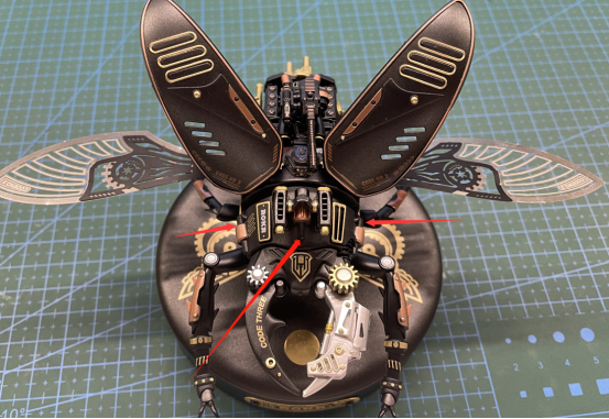

  1. Stuck.

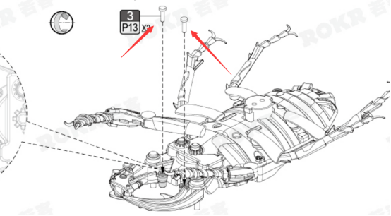

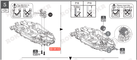

① Check if P13 is misused as a screw, resulting in the clamp stuck.
② Check if the three screws on the head are too tight.

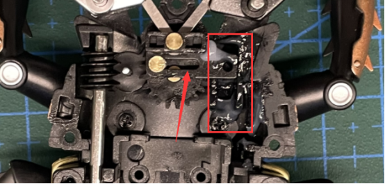

③ Check if A9 is greased.

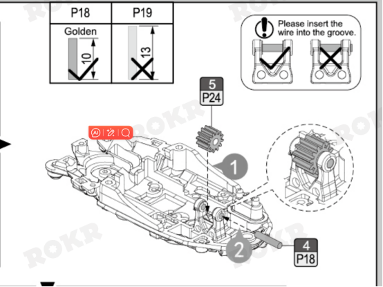

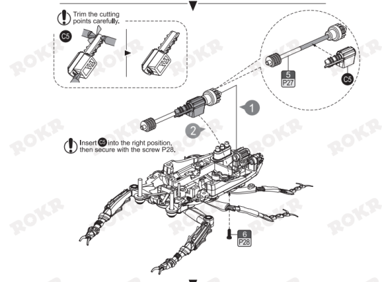

④ Check if direction of C6 is assembled reversely; if P18 is used correctly.
⑤ Check if the cutting points of C5 are cut clearly.
⑥ Check if P18 is misused as P19.

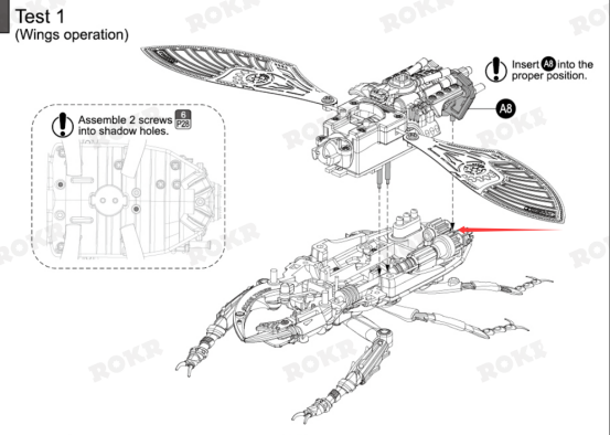

⑦ Do not press A8 completely to the end (This is very important).

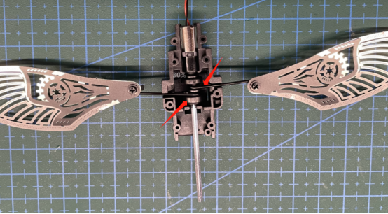

⑧ Check if the wing linkage is assembled reversely.
