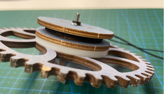

  1. Pull the clock weight straight to the bottom.

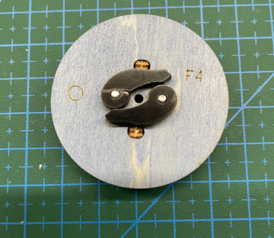

①Check if the thread has been wound three times.
②Check for the assembly direction of the ratchet.
