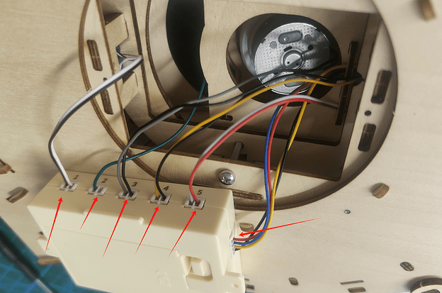

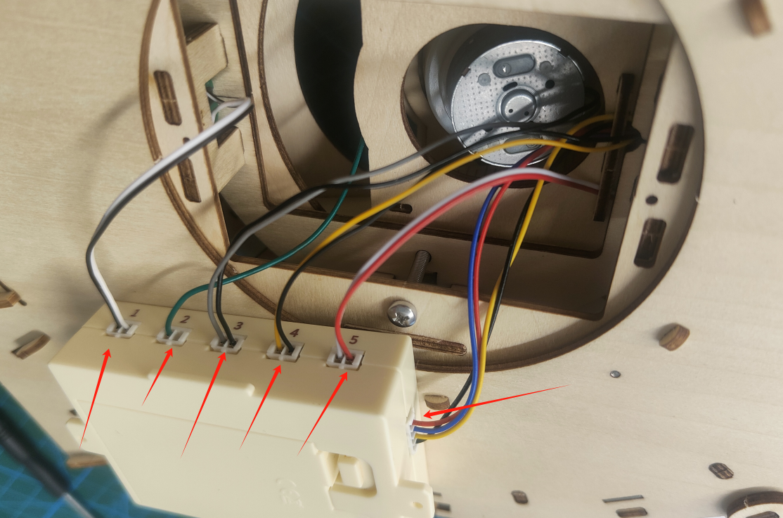

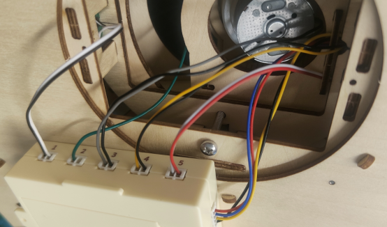

  1. There is no response at all after touching the switch: check if the positive and negative terminals of the battery and the wiring of the battery box port are correct.
  1. Click the touch switch and the light flashes once and stops. Click it once and it flashes once and stops: check if the wiring of the battery box port at the bottom is correct.

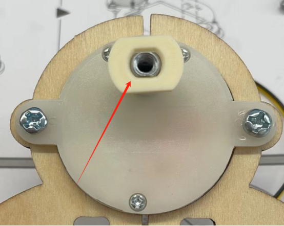

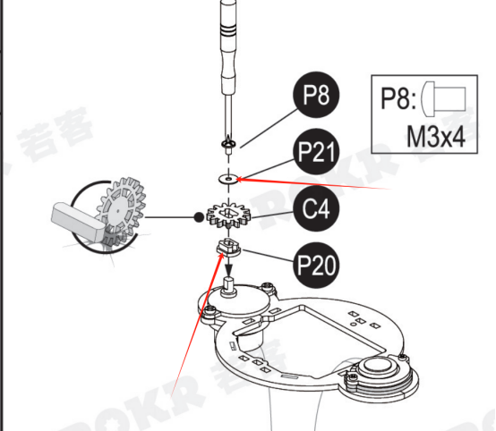

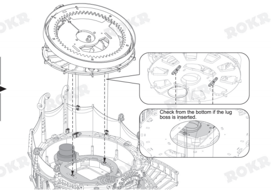

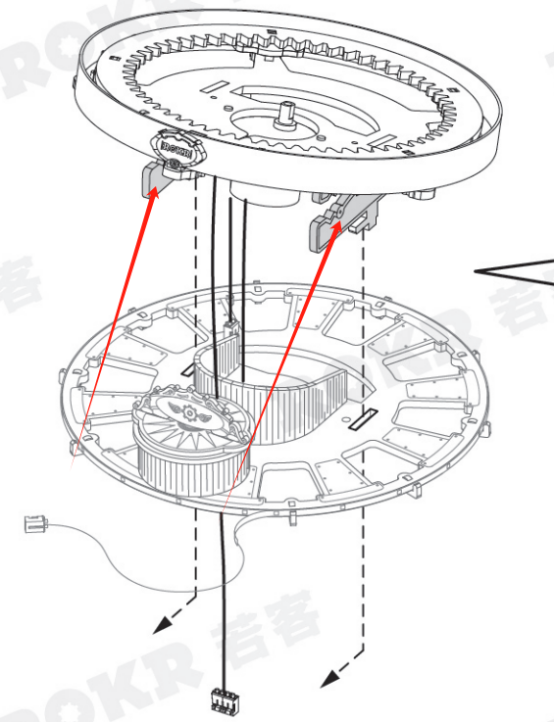

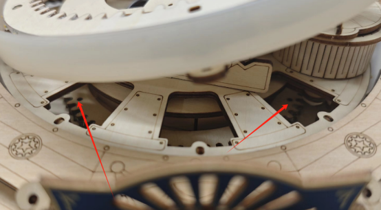

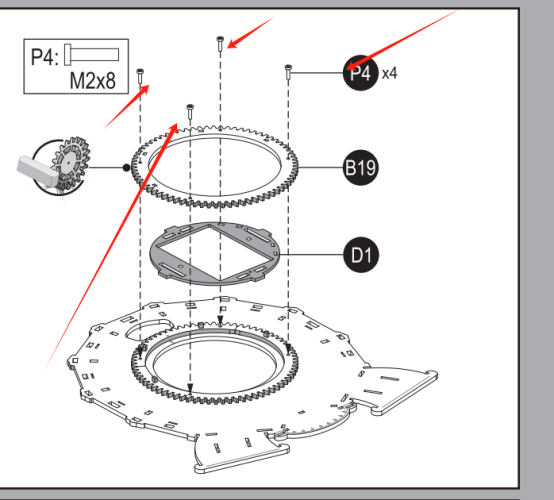

  1. The product does not rotate after the base is assembled:
    ① Check if the components of C11 and C13 are pressed to the end.
② Check if P20 is assembled reversely, and if P21 is missing.
③ Check if the screw P10 at the bottom is tightened and if the screw P4 is tightened.

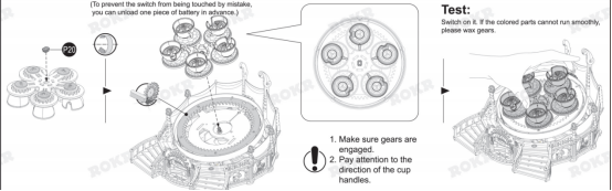

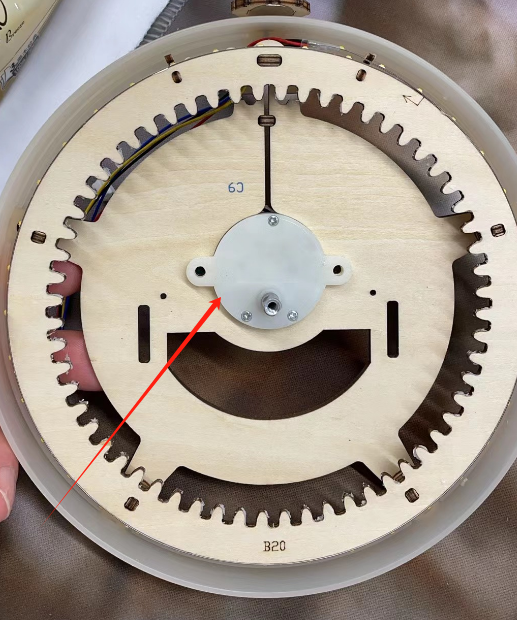

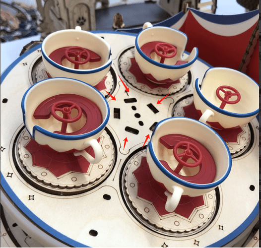

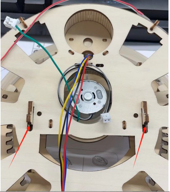

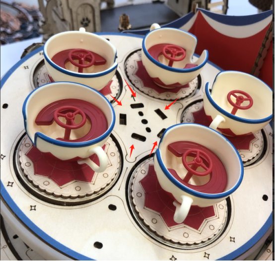

The assembled cup does not rotate.
①Check if the positive and negative poles of the battery are right, check if P20 is assembled, and check for the direction of the cup handles.
②Check if the motor is connected to P13 the Gray&Black wire, and check if the motor is assembled on it.

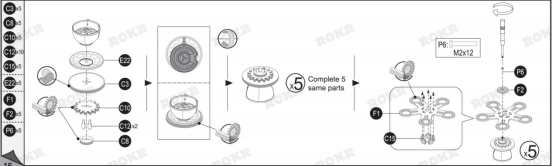

③Check if C8, C10, C3 are polished and waxed, and if F1 is polished and waxed; check if F2 is missing, and if C2 is polished; check if C2 is assembled reversely.
④C2 is not completely pressed to the end.
