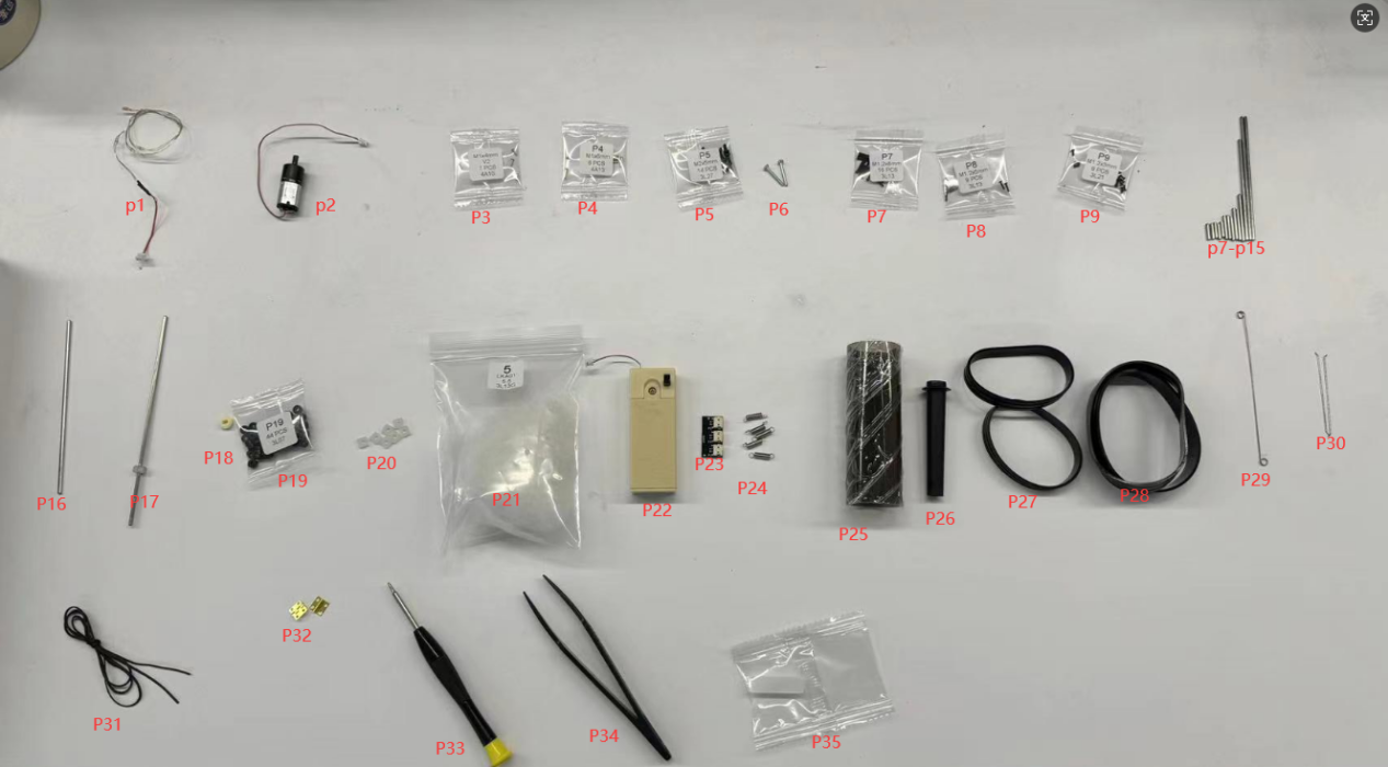

Parts Problem

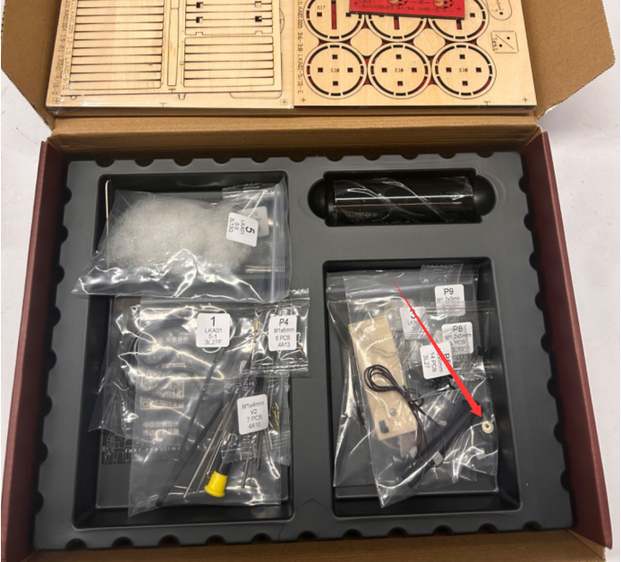

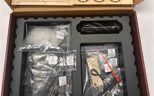

1.Part P18 is missing.
It is on this bag as shown in the picture.

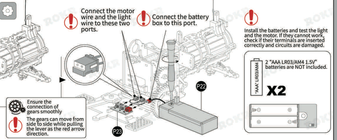

No movement after testing and assembly
  1. Motor does not not move, check the test steps:
    (1)Check if the wiring is wrong, the battery box can only be connected to the outer interface.
(2)Check if the switch is on.
(3)Check if the battery is new.
(4)Check if the terminals are inserted reversely.
(5) Check if the wire is pressed by previous steps.
(If the above steps are checked and the problem are not solved, replace parts as appropriate.)

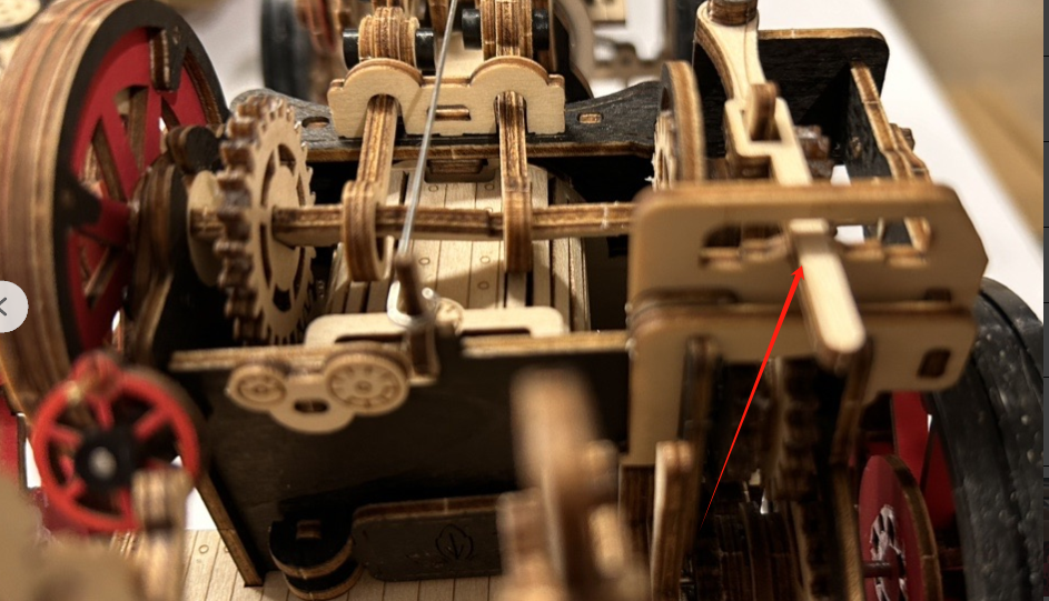

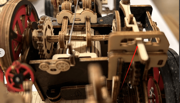

2.The product is not in operation.

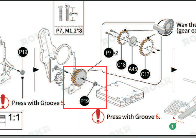

Check if the transmission is in neutral.

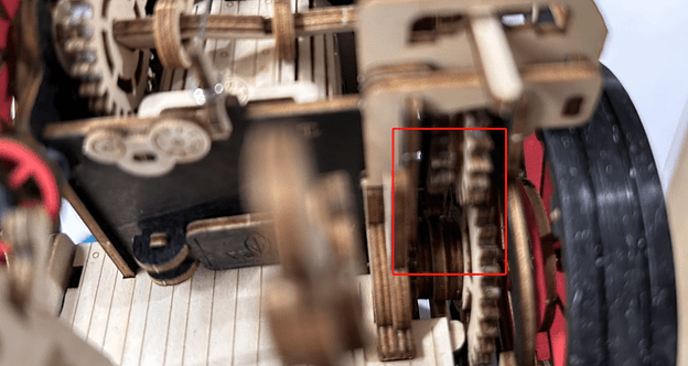

3.Check if the gears are engaged. If not engaged, check if P19 is missing.
