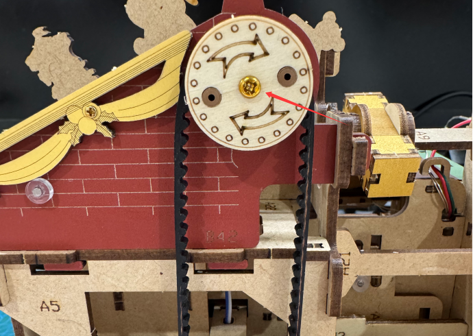

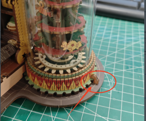

1.Part P15 needs to be screwed in with some force.
2.Failure to assemble Part B5 will cause the Christmas tree not to rotate.
No rotation after testing and assembly.

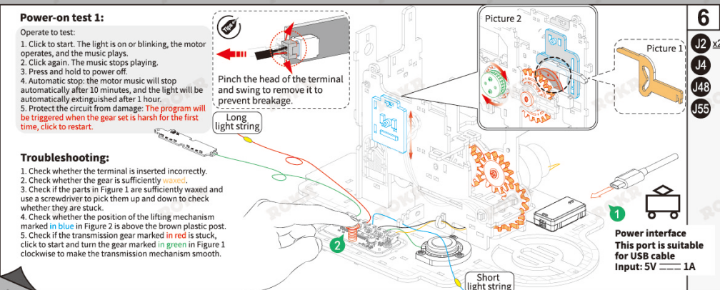

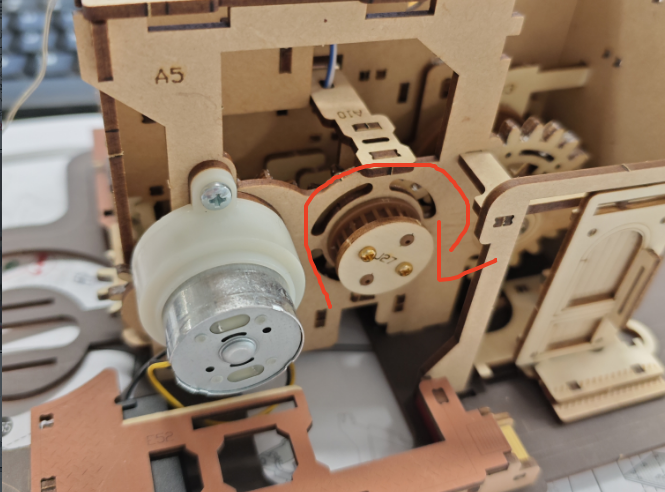

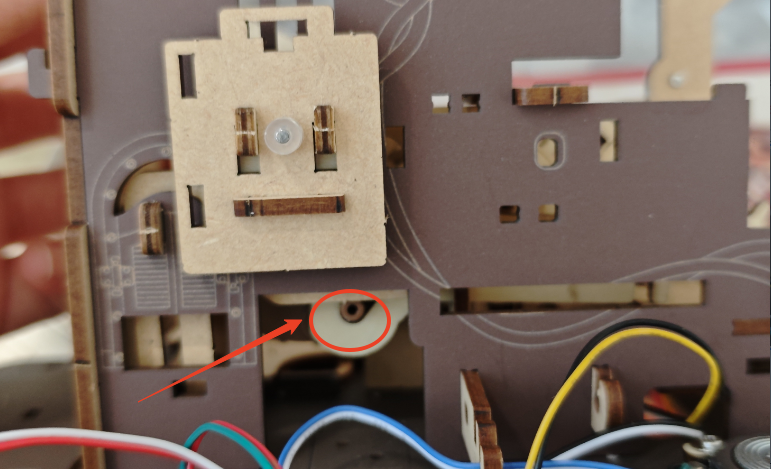

2.Power-on test 1: Motor not rotating or gears not rotating/rotating with stagnation.
(1)Protect the circuit form damage: The program will be triggered when the gear set is harsh for the first time, click to restart.
(2)Check if the terminals are inserted reversely, incorrectly, or tightly (pinch the head of the terminal and shake to remove it to prevent wire breakage).

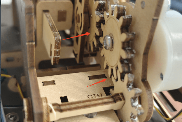

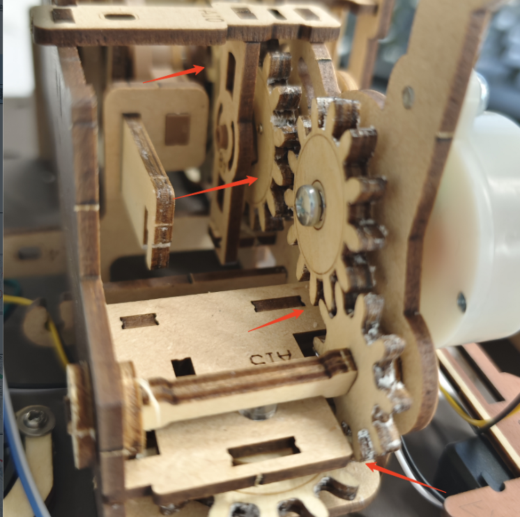

(3)Check if the gear is waxed.
(4)Check if the part H3 is waxed. Use a screwdriver to pry and check if it is stuck.
(5)Check if the lifting mechanism is above the brown plastic post.
(6)Check if the gear in front of the motor is stuck, click to start and rotate Part J27 clockwise.

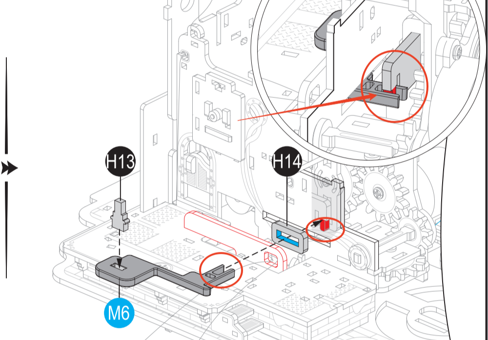

3.①Check if Part M6 impede Part H3.

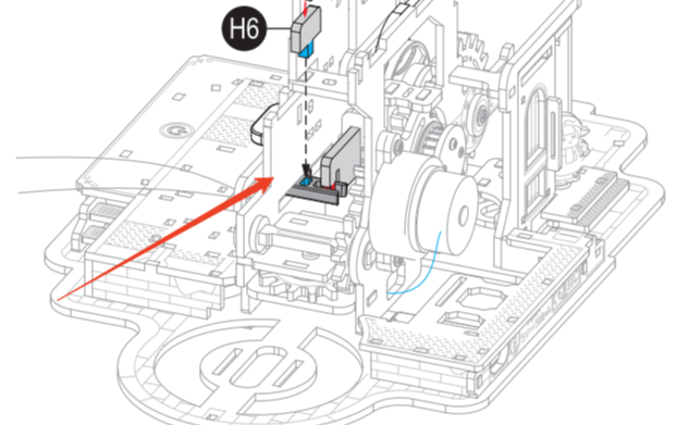

②Check if H6 is stuck in the process of assembly.

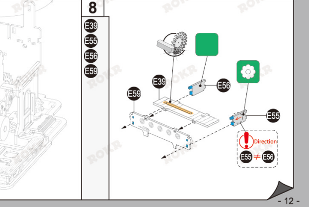

③Check if A11 and E39 are waxed.

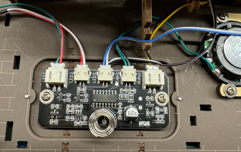

4.The speaker/light does not work.
① Check if the wire connections of the circuit board are right. The two interfaces in the middle are light. And the others are speaker.
(If the speaker’s wires are inserted into the wrong interfaces, the light in the speaker interface will flash, the other light will not light, the speaker will not sound, and the motor will rotate normally.)
② The two light interfaces are interchangeable. If one light does not light, it can be tested by switching to the other interface.
③It can be replaced if the part has any problems.
